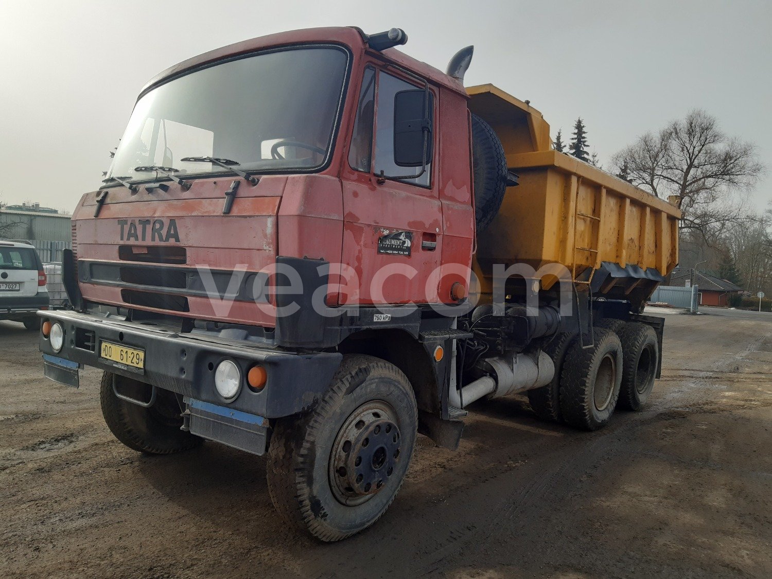

Post 1989-1993 Tatra 815-2
Image Veacom.cz
Image Pmht.net
Image Truck1-pl.com
Veacom.cz
Pmht.net
Truck1-pl.com
